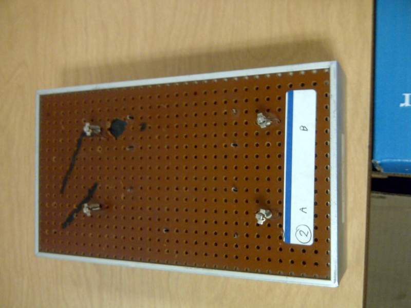

I need to design a lab to solve for which circuit is parallel, and which is series. I also need to figure out the resistance in each resistor (each resistor is the same, so I need to find one of the resistances).
Here is the information given:
Given four identical resistors and two circuits, one in parallel, one in series, and both including two of the four resistors, which circuit is parallel, which is series, and what is the resistance of each resistor.

The two things that I haven't been able to figure out are how I can figure out...
1. Which circuit is which (either parallel or series)
2. The resistance of the parallel circuit.
P.S. This is all DC current.
Thanks for your help! Any ideas are appreciated!
Here is a picture of the circuit apparatus, in the real lab, the box will be sealed and it will not be known which circuit is parallel and which is series.
Try a couple of sample values for the resistance and calculate the expected resistance you would measure for each case.
Presumably in the lab you'll be measuring the resistance of the hidden circuits and then be asked to identify which is which. The above exercise should help you see what to look for.

Thanks for the reply,
Does that mean that since the resistances are equal, the one with the smaller total resistance will be the parallel circuit??
Try some values and find out. Doing is the best way to learn and remember.
