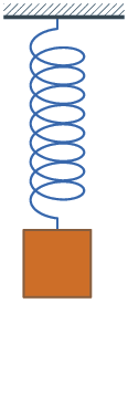

In engine, there is valve and the valve spring. If you have ever look at the valve spring before, then you will notice that one end has its coil closer together than the other end. So a valve spring is a kind of progressive spring.
In almost all engine repair manual I read, the instruction is always say that the end of the valve spring which has closer coil should be facing down (i.e. closer to the valve).
1) Why the closer coil end must be always touching the valve?
2) What will happen if the spring is put upside down?
I have search in the internet and I found that the reason for using a progressive spring as valve spring is for the dampening effect, otherwise more complex alternative approach has to be used such as an inner spring design.
However, the spring as a single entity, wouldn't it performs the same regardless of how we put it? Let's be more general, imagine we have a progressive spring (not necessary the valve spring but a general progressive spring), and then this spring is used to do the normal oscillation experiment. In the first experiment, the end with closer coil is facing down. So we get a set of measurement of amplitude and frequency of oscillation.
Then repeat the experiment but let the end with closer coil facing up, we get another set of measurement of amplitude and frequency of oscillation.
3) Will the first experiment result and observation identical with the second experiment? If it is not, why?

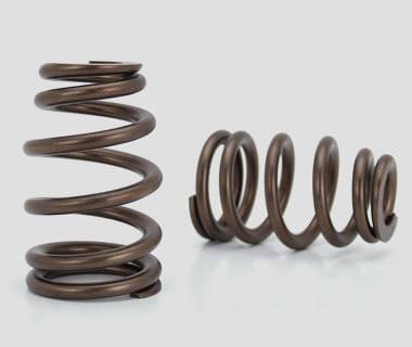

These are more like the function of the uniquely shaped valve spring, but it doesn't explain why the more coil end has to always face down.
BTW the spring picture you provides, doesn't look like a typical valve spring of engine, maybe those that I seen are old design.
The typical valve spring look like this:
http://digmyhonda.com/wp-content/gallery/cache/334__320x240_install_valve_springs42.jpg
Thanks for the photo
the shape provides better valve control with Increased harmonic resistance. This increases stability and reduces damaging harmonics.
The close coil design places maximum surface area at the point of highest stress
In short , this design reduces potential of valve float when engine is over revving
I think the OP is making the point that if we were to assume the spring had negligible mass, there wouldn't be any reason to have the spring installed one way versus the other. If we looked at the spring and valve assembly under static conditions, then for any valve lift, the spring load on the valve is the same regardless of which way up we install the spring. The valve spring doesn't 'know' that it is upside down in the static condition or if we assume the spring has negligible mass. So the assumption that the spring is static or has negligible mass must be wrong, but why?
The difference is that one end of the spring is static and the other end of the spring is dynamic. The end of the spring against the cylinder head isn't moving but the end of the spring against the valve spring retainer is moving very quickly. Note that if we were to determine the velocity of any part of the spring from one end to the other, there would be a roughly linear change in velocity from 0 against the valve head to some maximum velocity at the spring retainer. The coil velocity increases the closer we get to the spring retainer. The objective is to minimize the amount of weight on the spring retainer during this motion.
In a progressively wound spring, the more closely wound coils make contact after a small amount of movement and become ineffective. That's what raises the spring constant. The spring constant increases for a progressively wound spring when these coils make contact and no longer flex. If they aren't contributing to the spring load, it doesn't make sense to have them moving up and down. That just adds weight to the valve assembly. So the point of putting them against the cylinder valve head is to minimize the weight that is moving (the sprung weight is being minimized). When you do that, the resonant frequency of the assembly is increased - there is less mass being supported for any given spring load. And for a spring that's moving as fast as these springs do, that makes a difference to the natural frequency of the assembly. You don't want the natural frequency of the valve assembly and the frequency of the motion to coincide. That explanation should coincide with what Ranger Mike is saying, but hopefully it helps explain in a bit more detail.

Q_Goest said:
I think the OP is making the point that if we were to assume the spring had negligible mass, there wouldn't be any reason to have the spring installed one way versus the other. If ... ...
Thanks to Ranger Mike and Q_Goest.
Q_Goest you correctly interpreted my intention. Your explanation helps a lot, it now make a lot more senses to me. Let's see will there be any other suggestion on the purpose of the orientation of the valve spring.
Nevertheless, Ranger Mike provided enlightening information too.
So I believe question (1) has been answered. Would you mind to comment on the question (2) and (3)?
question 2 has been answered, by the answer for question 1.
Same for question 3.
In a static situation, the spring in either orientation will perform the same.
When oscillating, either orientation will perform differently as described above due to one end of the spring having stightly greater mass and due to a variable spring constant as the spring is compressed.
