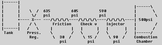

If I'm designing an injector for a rocket engine, I have a specific mean flow rate (m/s) that must be met due to the pipe diameter and the required mass flow rate.
I've calculated all the pressure drops due to lost work from friction, valves, and orifice geometries (not from change in area, but due to the complex internal geometries that lead to losses in energy).
For calculating the necessary area of the injector plate orifices what pressure drop should I use? Should I use the pressure drop I determined to get the required flow rate or should I do this:
pressure drop over injector = (the required pressure drop to achieve the required mass flow rate ) - [(pressure drop from friction) + (pressure drop over check valves/etc)]
or this:
Pressure drop over injector = pressure drop to obtain required mean flow rate
Example: The combustion chamber is at 500 psi. I need a pressure drop of let's say 90 psi to get the required flow rate into the combustion chamber. The pressure drop from friction is 30 psi and the pressure drop from a check valve is 15 psi. For the pressure drop over the injector should I use 90psi (regulator below tank would be set to 635 psi) or 45 psi (regulator below tank would be set to 590 psi in this case)?

Restrictions, etc would cause a pressure drop only.. flow in = flow out, so velocity wouldn't go up or down unless you're changing piping diameter... at least for liquids.. for a gas a change in pressure will come with a corresponding change in temperature and volume.
Not quite sure how to answer part 2 though.. perhaps someone else will chime in

As shown by Tom.G,, total pressure loss is the sum of the pressure losses across each section / component of the path.

There is a minimum pressure differential required to provide a given flow rate through a nozzle based upon the diameter of the nozzle and it flow coefficient (efficiency) and a well designed flow nozzle can have a coefficient of as high as .98 (98% of the theoretical nozzle flow).
There are two methods with which you can approach your nozzle issue:
One is to work your problem backwards starting with the expected pressure on the discharge side of the nozzle to determine the required nozzle inlet pressure to provide your required fuel flow and then add the pressure drop values of the upstream piping and components to determine the required supply pressure to provide your required fuel flow.
The other, if you already have a specific supply pressure, then is to calculate the nozzle diameter based upon attaining your required flow based upon the differential between the inlet nozzle pressure after subtracting your upstream losses and the expected downstream nozzle discharge backpressure.
