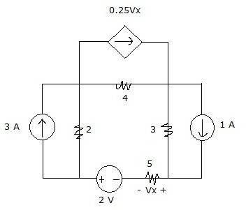

Find Vx using source transformation

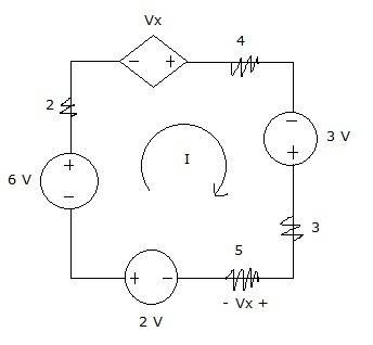

After doing source transformation on the three pairs of current sources and resistors...
KVL:
-6+2I-Vx+4I-3+3I+5I-2=0
14I-Vx-11=0
but Vx=5I (is it? I'm not so sure about this)
14I-5I-11=0
1I=11
I=1.222 A
Vx=-5I=-5(1.222)
Vx=-6.11 V
Did I do the source transformation right? Also, I'm confused with the value of Vx. Is it -5I or just 5I? Because in our class, our convention is that when a current source is transformed into a voltage source, the part where the arrow head in the current source becomes the positive terminal for the voltage source. But since we're only dealing with a resistor here, I just followed our convention for the KVL (the voltage across 5 ohms is positive since the mesh current enters the positive terminal)

Everything looks fine except for your last two lines! Vx is in fact 5I, since its specified polarity indicates that it's a drop in the same direction as your current. So Vx = 6.11 V.
thank you very much for the verification sir!
