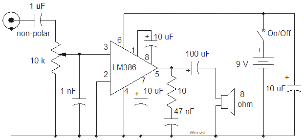

hi all,
i want to design the following circuit. The circuit should listen to the audio and amplify the audio. could somebody provide me the circuit or help to design the circuit like which components shall i take for the audio input, the speakers what i have to select and additional things.

For a low powered amplifier, the LM386 integrated circuit is usually easy to find and does a good job.
Here is a circuit using one:
http://t2.gstatic.com/images?q=tbn:ANd9GcTYuoLxQEwxLSdKGTH8GiQj_yzkrtHEfgp3C6cQ9GexVYvuDOWAxQ
You may not need the LM741 preamp.
Here is another LM386 circuit:
That circuit came from this page which has several other amplifiers:
http://www.techlib.com/electronics/audioamps.html#LM386

Listen i mean to say a microphone as the input and the connecting circuit which would amplify this small signal to a large volume signal. i think i am mixing a lot of terms. finally the summary of my project is like what ever you speak (audio signal) should be taken by a microphone and amplify it many times so that it can be audible to some distance say in another room or like that. i hope you understood.

thank you very much for the reply, the circuits are really helpful. Now my only doubt is in the circuit diagram i think the terminal you have shown a circle with a black dot is the input terminal where i need to connect a microphone. if possible can you suggest what type of microphones i can use? iam very much new to audio amplifiers. This clarification would enable me to build the circuit practically and see the output.

You can use any mic that you can get easily. The 356 is gain adjustable. The only thing I am concern is the 10K volume control right at the input. I would use a 50K minimum to avoid loading down the mic.
There is only one type of microphone available now. It is called an electret microphone.
These are quite good, but they need a power supply. You just take power from the amplifier +ve voltage via a 4.7K resistor.
The metal case of the microphone is grounded and the 4.7K resistor goes to the other wire of the microphone.
You take the output at this junction.
The LM386 shown in the diagram above is set for maximum gain of about 200. You can get less by putting a resistor in series with the capacitor between pins 1 and 8.
Even at full gain, the microphone probably won't drive the amplifier to full output, but it will be quite loud enough.
