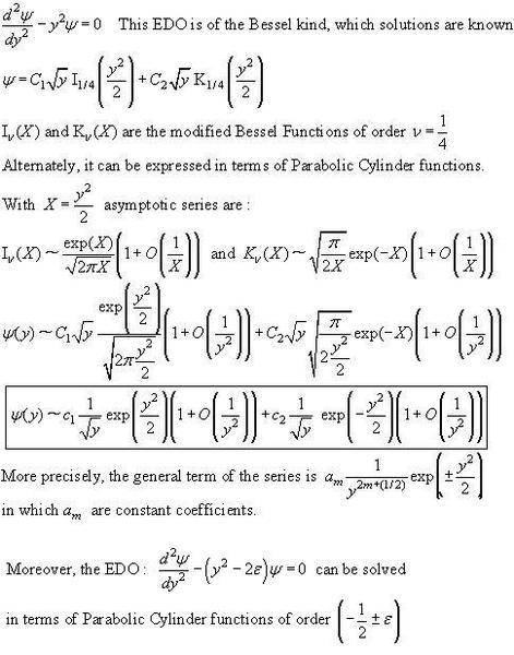

The solutions of this EDO are known in terms of Modified Bessel functions or alternately in terms of Parabolic Cylinder functions (in attachment)

For the ODE just use the Frobenius method. Series expansion.
Okay i understand, thank you very much
