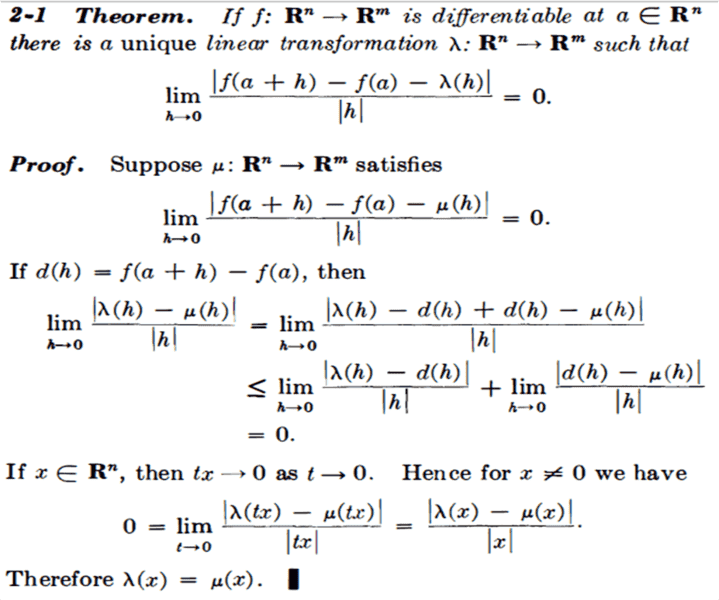

Hi--
I am trying to work through Spivak's Calculus on Manifolds over the holidays, and I am a little stuck on his proof of the unique derivative (on p. 16 as well as below).
Specifically,
(i) Why does the ≤ inequality hold, and
(ii) Why does the last equality of the second-to-last-line hold?
I would very much appreciate any help!
(i) The triangle inequality [tex]|x+y|\leq |x|+|y|[/tex]
(ii) Linearity of [itex]\lambda[/itex] and [itex]\mu[/itex]:
[tex]\frac{|\lambda(tx)-\mu(tx)|}{|tx|} = \frac{|t\lambda(x)-t\mu(x)|}{|tx|} = \frac{|t||\lambda(x)-\mu(x)|}{|t||x|} = \frac{|\lambda(x)-\mu(x)|}{|x|}[/tex]
