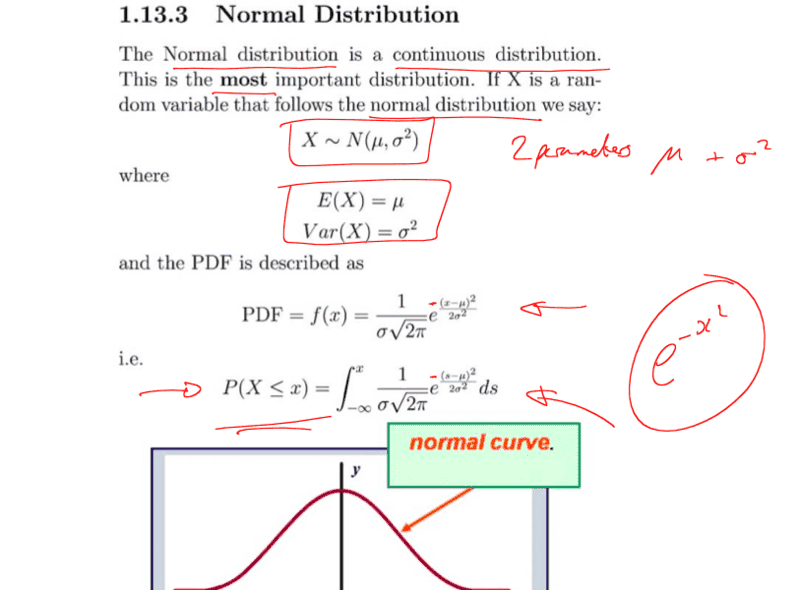

A Normally distributed random variable with mean μ has a probability
density function given by
_ρ_...*...((-ρ2(x-μ)2)/2δ)
√2∏δ|...e^
Its standard deviation is given by: A)ρ2/δ B)δ/ρ C)√δ|/ρ D)ρ/√δ| E)√δ|/2ρ
Now I know that the probability density function of a normal distribution is given by one over sigma * the square root of two pi, all times e to the power of negative (x minus mu) squared over 2 sigma squared.
The differences between this equation and the PDF for a normally distributed random variable then are minute and come to ro instead of 1 and the square of sigma instead of sigma in the outer part and ro squared as well as sigma not being squared in the denominator of the exponential.
What I don't know is how to parse out the standard deviation from all of this. Am I to integrate it? If not, which parts of the probability density function comprise its variance or standard deviation. Any guidance would be much appreciated.
Also, apologies for my shoddy depiction and description of these equations. A clearer version of the problem I'm working on can be found here: http://www.7citylearning.com/cqf/pdf/maths_test.pdf It is question 13.
I'll also attach the notes I'm working off of in trying to solve this query.
