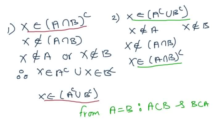

Hello, i proved the first demorgan's rule and using that i can easily proof the second one, but i tried to prove it as how i proved the first one. I would like to know what i did is correct, i feel i what i did might not be correct.
(A [itex]\cap[/itex] B)c = Ac [itex]\cup[/itex] Bc
proving through the fact that if;
A=B
then following two should be satisfiable:
A[itex]\subset[/itex]B and B[itex]\subset[/itex]A
Seems correct!
