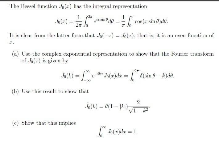

I would be grateful if someone could help me out with the problem that I have attached. I believe I have successfully answered part (a) of the question but am completely unsure of how to approach part (b). I realize it must have to do with specific properties of the delta function but I am lost. Any assistance would be greatly appreciated, thanks.
