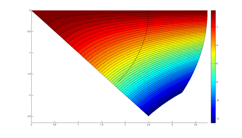

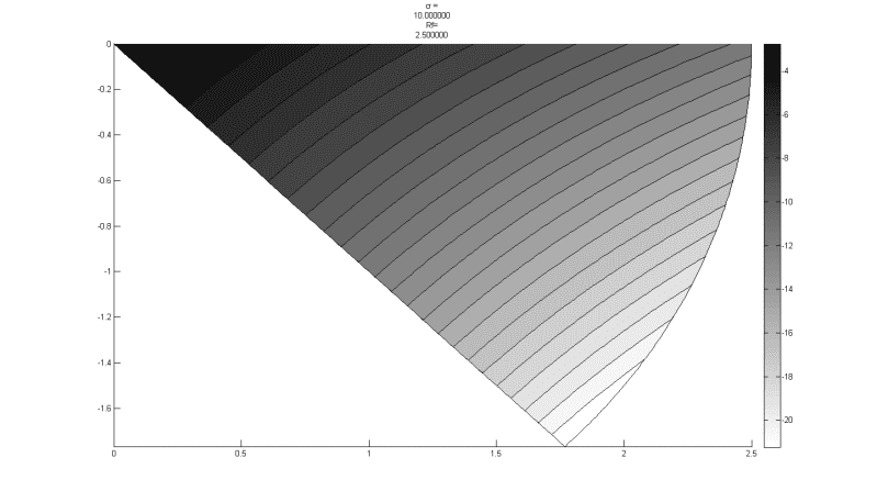

The problem I'm having now is in the implementation of the free surface boundary condition (when [itex]\bar\theta=0[/itex]).
This is a graph produced using the analytical result:
https://lh4.googleusercontent.com/YGjbspVigI58cmMU02IvXSFxVreWQ4B4jrsToC--TNzEAGf3O0_CjIu6jouvfx1xXE5U6SyLdQ4f9uqKwS55rB6Zs63B3W8ep9A=w1600
And using my method:
https://lh5.googleusercontent.com/pwIa6Y4c4oe1P0RrazI5pgpQm5rrEc4azNujnt7HVNh9zDtO078kl4yQrXfZiPOjHswI0qRyc1-XcBdrA3UVFpS2ciMFAwh6G9U=w1600

The numerical results:
The analytical results:
As you can see, the issue lies with the values at the free-surface.
I've never dealt with any boundary conditions involving two separate functions before (here [itex]\hat\phi[/itex] and [itex]\hat\eta[/itex]), if anyone could point me in the direction of some reading material on this matter it would be much appreciated.
Your two domains are different. Which of the two is supposed to be the correct geometry? Also, the domains are really off since none of the dimensions match, and neither does the number of boundary segments. Unless you get the domains to have the same contours you cannot compare your results.
I am not familiar with near or far field BCs, but what I can say at this point, is that your plots definitely defer by one boundary condition. Supposing that you are plotting equipotential lines here, in your numerical plot the top horizontal line has a Neumann boundary condition (streamlines are perpendicular to the boundary). You have probably not defined that boundary condition in you analytical solution, which is why your analytical plot looks like this.
