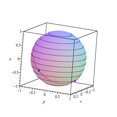

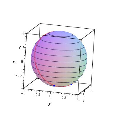

Thinking about it:
you need to make the problem clear.
you want to find the parametric equations for a unit circle that has been tilted with respect to the z-x plane.
you need to specify the axis and angle of the tilt - specify the axis as a vector and give the tilt direction by the right-hand-screw rule wrt this vector.
if we imagine the axial vector to the circle starts out pointing in the +y direction, then the angle it ends up forming wrt the y-axis is the tilt angle.
From your description I am imagining a tilt angle of +45 degrees about (1,0,1).
[see attachment - green=x-axis, red=z-axis, magenta=y-axis]
that should clear up your thinking somewhat.

Did you see the attachment I posted? It shows the circle plane clearly, and it's not just tilted with respect to the z-axis. Actually it is rotating at a 45 degree angle to the x/y axis too, in addition to being skewed with respect to the z-axis.

I saw that - did you see mine?
Yours looks like -45deg about (0,0,1) followed by -45deg about (0,1,0)
Can you confirm?
[x and z both > 0 means y <0?]

fracs49er said:
Your picture certainly looks like how the velocity vector appears on my diagram (Good job!), but then those two original points were supposedly in error, and the points I later posted supposedly correct. I tried setting up the cross products as in your formula, using the updated points for 0 and 90 degrees (0, .707, -.707 and .866,-.354,-.354.) That returns the same identical points when I enter 0 and 90 for t, and all angles for t that are in 90 increments from 90 also appear with the expected values. But when I enter 30 or any other angle that isn't a multiple of 90, then I get points that don't agree with what my associate had calculated, but they are in the approximate range that would be expected. For example, for 30 degrees, instead of .354,.354, -.866, your formula returns .433,.436,-.789. So I don't know what that means. Either my associate was wrong in his original calculations, or your formula only works with angles of 90 degree multiples, or my code is buggy in some way. (Note: using 30 degrees for vector v doesn't work for any angle except 0.) Did you plot your picture using continuous angles 0-360 outputted by your formula or did you simulate the curve in Mathematica? If the former, I have to think that my associate's earlier data for the frequency vector points was flawed in some way.
I ran my program using your new points inputting notation for exact values instead of decimals:$$
(0,\frac 1 {\sqrt 2},\frac{-1}{\sqrt 2})\,
(\frac{\sqrt 3 } 2,-\frac {\sqrt 2} 4,
-\frac{\sqrt 2} 4)$$ My formula gives the values you indicate for ##\theta = -\pi/6## (Plus or minus just depends on which way your orientation takes you around the circle.) I used Maple to plot the continuous circle the formula gives and the result is shown below. There isn't much doubt the method and formula are correct.
Yes, there isn't much doubt now that the vector cross-product method works. I want to thank everyone who contributed to the solution and to my better understanding of great circles and velocity vectors, and especially LCKurtz for providing a solution to the problem that I could finally sink my teeth into!
