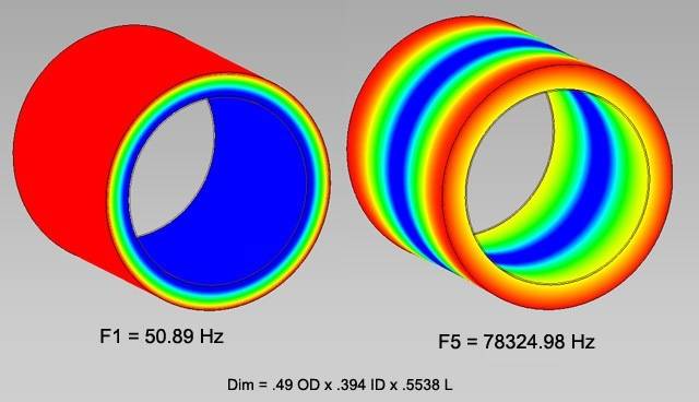

Hi, I'm trying to locate a formula for determining the radial breathing mode of a hollow cylinder.
The dimensions of the cylinder of interest are approximately .5" OD x .4" ID x .5" L
Any help would be greatly appreciated. Thanks!
Researching further I came across this formula that someone posted for determining the "ring frequency" for a hollow cylinder:
Ring frequency = sqrt(E / mu) / (Pi * d)
In the post he suggested that "The ring frequency is often called the breathing mode because the ring simply expands and contracts whilst retaining its circular shape."
This definitely sounds like the radial breathing mode vibration to me however he further describes the ring frequency as follows, "The ring frequency is the frequency where one longitudinal wavelength fits exactly around the circumference of the ring or cylinder."
Can someone please confirm this for me? Is the formula mentioned for this ring freq the same one for determining the RBM? I would very much appreciate it. Thanks!

Ok, that's what I thought. I ran the model through a CAD simulation and here is what I ended up with:
There appears to be two modes that have the breathing effect (F1, F5). When viewing F1 axially it appears to expand out from it's original position. F5 appears to contract in the central region while the outer edges seem to keep their original shape. Looking at this image can you tell which one is the actual breathing mode?
Using the simple formula and going with the OD value (.49"), I came up with 92521.89 Hz which is much closer to F5 so I am leaning toward that mode, however it's off by 14197 Hz (92521 - 78324) which seems to be a considerable amount. Am I missing something or is that to be expected given the kinetic energy from the axial motion you mentioned? Perhaps I need to locate a more accurate possion's ratio value... I wasn't able to find much info on that.

Using the mean diameter I get 102 KHz.
Has your model got any restraints imposed on it? If it doesn't, you should have got 6 zero frequency modes (rigid body translations and rotations). Compared with 100 KHz, 50 Hz could be a zero frequency. I suspect it is actually rigid body rotation of the ring about its axis. The motion of any point on the ring is along a tangent, and when you scale up the animation to a finite size it looks as if the diameter is increasing, even though it isn't really. But if there should be 6 rigid body modes, why is mode 5 obviously not a rigid body mode?
Mode 5 could be an axial vibration mode. That would have frequency sqrt(E/rho) / (2L) which is the same order of magnitude as the breathing mode.
My suspicion is that your model is restrained somehow, which it shouldn't be. Plctures of all the first 7 or 8 modes (and the frequencies) might help understand what's going on, if you can't figure it out.
What do the colors represent?
Ok, you were correct... I was restraining it. After removing the restraint I'm now getting the first 6 rigid body modes which are showing a 0 value for their freq. Now I am seeing what appears to be a breathing mode at F19 (78.3KHz) and F30 (102.46KHz). They are both doing different things though and I'm still not sure which one can be considered the actual breathing mode. I created some animations of them though if you would like to have a look at them:

Also, this 6th 0 freq mode appears to be "breathing" to me... can you verify that it's indeed a rigid body mode?
http://www.yantra3d.com/cyl/F6_0.avi
Thanks again for all your generous and invaluable help btw... I really appreciate it!
Mode 6 has got to be a rigid body mode, from the frequency.
Your 78 kHz mode looks the same as when you had some restraints. It looks like longitudual vibration of a rod to me. Presumably the restraints in your first model didn't affect that vibration mode.
I don't know what to make of the 102 kHz. I wonder if your FE models aren't refined enough to get a "clean" picture. If you are generating a "random" mesh automatically, that will tend to break the perfect symmetry.
One way to check that is to look at the table of frequencies. For any modes that have "wiggles" round the circumference, (or that look like bending of a short beam) you should be getting pairs of modes with identical frequencies, but the two mode shapes clocked round by "half a wiggle" relative to each other (similar to graphs of sine and cosine functions). The single frequences left over will be the radially symmetrical modes. If most of the frequencies aren't coming out in pairs (equal to at least 3 or 4 figures) the finite element model has lost the symmetry of the structure somewhere.
If you can create a regular mesh (e.g. solid brick elements with say 10 along the length, 30 round the circumference, and 2 or 3 through the thickness) that should give a model that is "perfectly" symmetrical, and might be easier to understand.

The animations look right. Actually the "n=1" mode that you drew is a rigid body translation of a ring. For a cylinder, there are other "n=1" modes that do look like beam bending modes, as you said.
The reason n = 0 doesn't fit the pattern is because the stress and strain in the ring is fundamentally different. It isn't obvious from looking at the animations, but for n > 0 the length around the circumference remains constant (to first order). At the points where there appears to be no motion (i.e. no radial motion) the ring is actually moving tangentially, because the parts of the curve that are outside the undeformed circle are longer than the circle but the parts inside are shorter. The n=0 mode does not have constant length when the whole circle expands and contracts.
The kinetic energy of all the modes is similar order of magnitude, but the stiffness for a thin ring is much higher for n = 0 than for n > 0. The difference in stiffness is between squashing the ring out of round (flexible) compared with expanding it with uniform internal pressure (stiff). The frequencies for n > 0 depend on the thickness of the ring (the bending stiffness is roughly proportional to t3 but the mass is proportional to t) but the frequency for n = 0 is independent of the thickness.
Well, I think I discovered the source of my problem w/ not seeing the breathing mode in my simulations. I did some tests and with the length of the cylinder at < .3 I can definitely see the breathing motion as predicted by the formula. However, anything > .3L the breathing motion becomes distorted by interference from the longitudinal modes and so the motion was not obviously perceivable to my untrained eye. (At least that is what I believe is happening)
At about .3L the breathing shape begins to favor one end over the other causing it to contract more severely at one end compared to the other. At > .5 the ends appear to stay stationary while the inner section of the cylinder breath in and out (expand/contract) as expected.

Hm... that sounds like your FE model, or the solver, isn't good enough to handle it properly. The mode shape should (obviously) be symmetrical end-to-end.
I'm guessing you are using the FE package that is bundled with your CAD program and you are pretty much going with the defaults. If there is an easy way to tell it to generate a finer mesh, that might help.
I took your advice earlier and increased the subdivisions of the mesh but am still getting the same effect. It's actually triangulating the mesh so subdividing may not be the correct term here.
It may be the way I have it set up. The options I have available are single point and parametric dimension although both are producing the same results. Within those options I have settings for "contacts" and by default it's set to bonded (which is what I have been using). The other available options for contacts are; separation, sliding / no separation, separation / no sliding, shrink-fit / sliding, shrink-fit / no sliding, and spring.
Do you think it may have to do with the "contacts" settings?
Contacts of what with what? I would hope there aren't any, so it doesn't matter which option you pick. But of that list of options, "bonded" seems most plausible, followed by "separation" (if "bonded" is bonding to something that it shouldn't).
This is probably heading outside of my experience. We use a CAD package plus separate FE programs (more than one, for different applications) rather than its built-in FE analysis option. In fact we've had some bad experiences with people going off and doing their own thing with the built-in software, and either not fully understanding what they were doing, or not understanding the limitations of the software (or both!). (I won't name the package because I don't have any reason to think it is fundamentally broken - but using it isn't as "automagical" as the CAD sales people might want you to believe).
Beyond the general comment that I think your FE model has somehow broken the symmetry of the physical structure, you probably need somebody with expertise in your particular software.
Ok, thank you for all your help AZ... It 's most likely what you are saying I would think because I am using an CAD prgm and not a specialized FE prgrm and so that is likely the case here. But, I'll spend some more time working with it and see what I can find out. If I can track down the problem then I'll post what I find back here.
