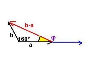

I think the way I am supposed to appraoch this problem is to make a third vector B-A which will connect to B and A to make a triangle. So I found B-A to be [-3.44,8.61,-20.68].
Then I found the angle between A and B by using the dot product(equal to -121.3) and found the angle to be 160 degrees. I did the same thing to find the anggle between A and B-A but the angle was 169 degrees. So this is not a triangle as the angles do not add to 180 degrees.
Can someone help me figure out where i went wrong and how to approach this problem?

Everything is correct, but you calculated the angle φ shown in the picture instead of the angle of the triangle (the yellow one). That is the angle enclosed by -a and b-a. Subtract 169° from 180°.
