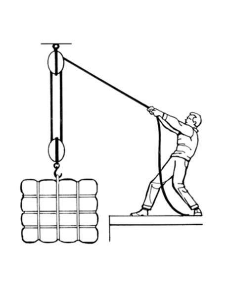

I see that in a pulley system if the distance of application of force is halved at the load end, the force gets doubled at that end. But even then the acceleration it produces at the load end in the absence of resistive forces such as gravity,friction etc is not what we expect from a=F/m. ie, even if 1N is multiplied to 2N at the load end the load of mass 1 kg is not accelerated by 2m/s*s in the absence of resistive forces. Why is it so?
In the block and tackle picture (courtesy Wikipedia), all of the ropes supporting the load have equal tension. ADD up the number of ropes supporting the load. The SUM of the number of ropes, MULTIPLIED by the force of the person pulling the rope, is the weight of the load.
