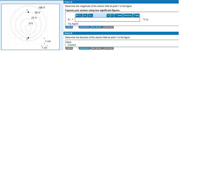

The question is in the paint doc...
What I did...
1st eq.
v = kq/r
q = vr/k
2nd equ.
E = kq/r^2
where am I going wrong...? For E I am getting 2500

The potential is not linear function of the distance, it changes 25 V from the second circle to the third one, and 50 V from the third circle to the fourth. The electric field is negative potential gradient, -ΔV/Δd. Use both circles, below and above the point shown to get it.
