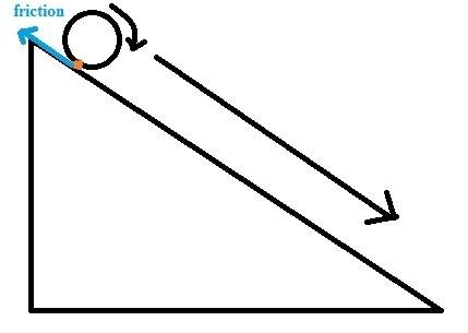

Thanks for your responses.
But, how if the case is like this (attachment - rolling the ball).
Then surely, the point where the friction force is exerted do have velocity. It move downward and experience the gravitational acceleration.. I still don't get it..
The term PE in the law appears due to conservative forces such as gravity, Electric field, etc. With a non-conservative force, mechanical energy is not conserved.
Friction force is non-conservative, however, the force you are talking about is not friction! ( it does not depend on coefficient of friction).
Imagine a gear ( or a ring) with very fine teeth is rolling down on a surface with teeth of the same size . Due to the weight of the ring, a force is applied on the teeth and the tooth and according to Newton's third law, there is a reaction to the force. Since gravitational force is conservative, this force is conservative too and mechanical energy is conserved with some changes in PE.
