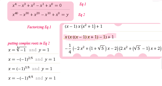

Hello. So here was this problem I came across:
If x^4-x^3+x^2-x^1+x^0=0, what is the numerical value of x^40-x^30+x^20-x^10+x^0?
I did try doing many stuffs (symmetry) & factoring, but I think none of these steps helped.
Enlighten the youngster, gracias.

Btw, the answer's 1.
Hmm... but How...?
I found no shortcut in doing this :rolleyes: ,
maybe then the only way to do this is find the roots and put them in the second equation ,
Yea lengthy it is
There could be a work around , using roots of unity , you need to think about it .
( sum of roots of unity and their properties )
our original polynomial is p(x) = x4-x3+x2-x+1.
note that p(-1) = 1 + 1 + 1 + 1 + 1 = 5, so -1 is not a root of p(x).
now consider q(x) = (x+1)p(x) = x5 + 1.
