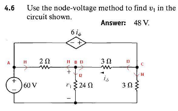

Hi everyone,
I currently stumped in the process of approaching a dependent voltage source problem using node voltages. Attached is the circuit.
What I know:
the Node north of the 60V supply with also be 60V
there are four nodes, two when supernodes are used
What I'm confused about:
with the super node being the 6iψ, KCL states the sums must be zero
when I try to solve, I end up getting the equation (using v2 as the junction of the dependent, and both 3Ω resistors):
[(60-v1)/2]+[(V2-V3)/3]+[V2/3]=0
I am not sure how to calculate the current across the 60Volt source
:confused:
In addition, I end up having a recursion problem trying to solve for iψ
Since V2 is 60+6iψ, and iψ is ([V2-V2]/3), I end up with
V2=60+6([V2-V3]/3)
any help would be greatly appreciated
Joe

Simply treat A and C as a one big (super) node.
So we only have one unknown node Vb
Current leaving the node is equal current entering the node.
For node B
Vb/24 + (Vb - 60)/2 + (Vb - Vc)/3 = 0 (1)
And one additional equation
Vc = Va + 6*Iψ = Va + 6*(Vc - Vb)/3 = 2Vb-Va = 2Vb - 60 (2)
So we have
Vb/24 + (Vb - 60)/2 + (Vb - (2Vb - 60))/3 = 0
http://www.wolframalpha.com/input/?i=+b/24+++(b+-+60)/2+++(b+-+(2b+-+60))/3+=+0

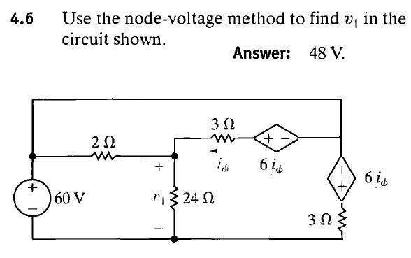

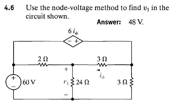

But we can remove the supernode from the circuit. We you can transform this circuit, legally, and get a new circuit which is equivalent to the old one
