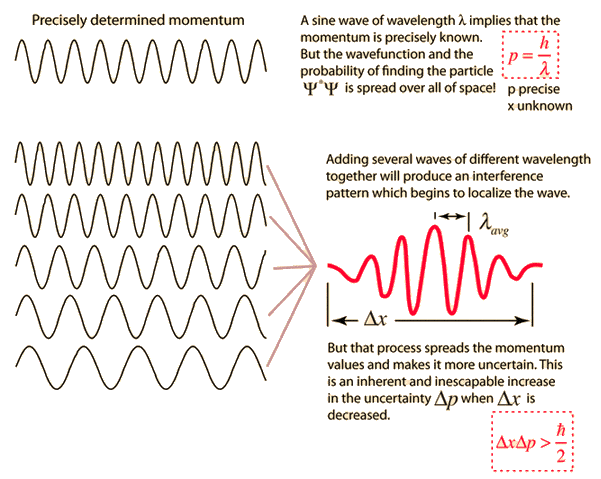

I thought I would post a couple simple images of a Graphical interpretation of uncertainty principle involving Planck's Constant and how it shows up when determining the energy for Particle Confinement:
From http://hyperphysics.phy-astr.gsu.edu/hbase/uncer.html
Planck's constant is not an uncertainty itself. But if, for example, you measure position to some fixed accuracy, the size of Planck's constant determines the minimum uncertainty in momentum.
