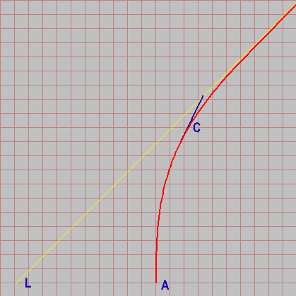

Yes, there is a region of space-time a uniformly acceleratig observer cannot see. The boundary between the region he can see and can't see is called the Rindler horizon. It's rather similar to a black hole horizon in many respects.
The Rindler horizon appears to be a constant distance behind the accelerating observer in his accelerated frame of reference (using the definition of simultaneity of a co-moving inertial observer to create said frame of reference).
Here's a spacetime diagram of the accelerating observer A. A and L have synchronised clocks and L sends a light beam to A at the time the acceleration starts. If A drops a device C, then C intercepts the light beam fairly quickly. It seems strange that the horizons existence depends on acceleration, not velocity. The moment the acceleration stops the horizon disappears.
