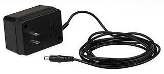

One way to be safe is to use a Underwriters Laboratories approved AC adapters aka "wall warts".
