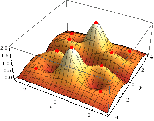

I have the function:
f(x,y)= x*(y^2)*e^-((x^2+y^2)/4)
I am not sure how to find the point where the gradient is the greatest.
The gradient I found after taking the partials is:
partial with respect to x: e^(-(x^2+y^2)/4)*((y^2)-.5(x^2)(y^2))
partial with respect to y:e^(-(x^2+y^2)/4)*(2yx-.5x(y^3))
What do I do next?
(I have also found min/max points for this function)

It is easier to work with the square of the magnitude of the gradient, rather than with the magnitude of the gradient itself.
Get that by summing the squares of the two components which you have found.
It sure involves some messy algebra !

The square of the gradient as you gave it, which I think is correct, is:
[itex]\displaystyle \left(e^{-(x^2+y^2)/4}\ ((y^2)-.5(x^2)(y^2))\right)^2 + \left(e^{-(x^2+y^2)/4}\ (2yx-.5x(y^3))\right)^2<br /> =\left(e^{-(x^2+y^2)/4}\right)^2\left(((y^2)-.5(x^2)(y^2))^2+(2yx-.5x(y^3))^2\right)[/itex]
[itex]\displaystyle =e^{-(x^2+y^2)/2}\left(16 x^2 y^2+4 y^4-12 x^2 y^4+x^4 y^4+x^2 y^6\right)/4[/itex]​
That's still pretty messy.
It turns out that the gradient is maximum where you might expect --- midway between neighboring min & max .

Below is a graph of your function as given by WolframAlpha.
Below is a graph of the square ot the gradient you gave as graphed by WolframAlpha with relative maxima indicated in red.
