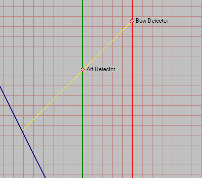

In the ship, they measure the speed of light to be c. If I've got your setup correctly, then it's obvious from the diagrams. The first one is from the emitters Pov, the second the ship Pov. In the ship, the distance traveled by the light is equal to the time taken, so they measure c=1.
