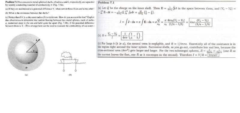

Look at the attached problem with solutions. I don't understand what the author means in c) when he says that succesive shells contribute less and less because the cross sectional area grows proportional to r2. The flux through a closed surface is always the same (Gauss' law). Rather the reason why the b becomes negligible is in my opionion that you are very far away from the shell. Can anyone explain what the author means by this "succesive shells contribute less and less"?

There is an elementary formula for the resistance, dR, of a thin slab of material of thickness dx and cross-sectional area A: dR = [itex]\frac{dx}{σA}[/itex].
See if you can apply this to a thin spherical shell of radius r and thickness dx = dr.
How does the resistance of the shell depend on r? What happens as r goes to ∞?
If you integrate the expression for dR from r = a to r = b you should get the formula for the total resistance of the material that lies between the sphere of radius r = a and the sphere of radius r = b.
