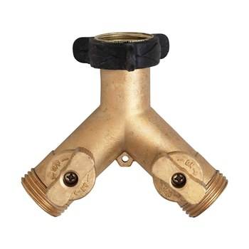

Two things are in parallel IF:
The voltage across one MUST be exactly the same as the voltage across the other because their ends are connected together by wires, and the current has a choice which way to go.
If you hook two garden hoses to a single faucet with one of these things
and put the other end of both hoses in the same bucket to fill it faster,
you have placed the two hoses in parallel.
Now - a node is where at least two circuit elements join together. That garden hose wye thingie in picture above would be a node because there's one way in and two ways out.
If there's only one way in and one way out i don't call it a node but some people do. To me it's a splice.
So in example above where the two hoses are in series, their junction i would not call a genuine node but a splice.
Some book authors disagree.
Back to plumbing analogy - to me a pipe coupling is a splice not a node, but a tee or cross or wye is a node.
