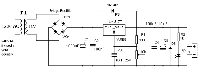

Yes they do, in general, the smaller the value of capacitance the higher the frequency
as far as audio applications go, it still depends on where in the circuit the capacitor is and what function you want it to perform... eg if its a bypass or say an interstage coupling capacitor.
Often in a regulated power supply you will see bypass capacitors of different values, have a look at this PSU ...
on the input to the voltage regulator IC you have C1 and C2
C1 1000uF --- large value for smoothing the DC out of the bridge rectifier
its bypassing the low frequency ( ~ 120Hz) AC ripple voltage to the 0V rail (negative rail)
C2 100nF (0.1uF) ----a small value... its there to inhibit any high frequency oscillations that may cause the regulator IC to become unstable, C4 of the same value does the same job
cheers
Dave
