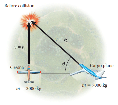

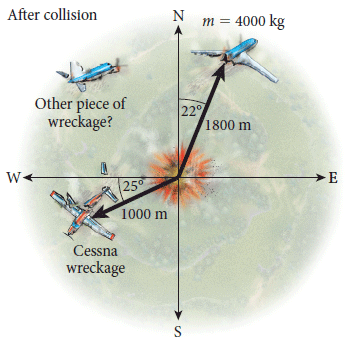

A 3000-kg Cessna airplane flying north at v1 = 70 m/s at an altitude of 1750 m over the jungles of Brazil collided with a 7000-kg cargo plane flying at an angle of θ = 34° north of west with speed v2 = 111 m/s. As measured from a point on the ground directly below the collision, the Cessna wreckage was found 1000 m away at an angle of 25° south of west, as shown in the figure. The cargo plane broke into two pieces. Rescuers located a 4000-kg piece 1800 m away from the same point at an angle of 22° east of north. Where should they look for the other piece of the cargo plane? Give a distance and a direction from the point directly below the collision. (Let to the east be the +x-direction and to the north be the +y-direction.)

P0=P.
Px=7000kg(111 m/s) cos34
Py=3000kg(70m/s)+7000kg(111 m/s)sin34
P=mv
Perhaps kinematics to find distance.
px=7000(111)cos34=644,162.2 kg m/s
py=7000(111)sin34+(70*3000)=644,492.9 kg m/s
P=sqrt (px^2+py^2)=911216.8 kg m/s

OK, good. Conservation of momentum is central and you can get the time of free fall.
If I knew the velocity in the x-direction, than the distance would be doable. If I initial velocity (v (terminal) in this case) then I could separate vy, get vx (which would be constant) and then get the distance that way.
You are given the horizontal distance traveled by two of the pieces. Can you use this info along with the time to get the horizontal speed of these pieces right after the collision?

Well, let's suppose you want to find the speed of the Cessna immediately after the collision (still 1750 m high). Use the horizontal distance the Cessna travels while falling and the time of fall. What do you get for the speed of the Cessna immediately after the collision?

For the Cessna:
first I need time:
v^2=v0^2-(2)9.81(0-1750)=> Vf=185.30
185.30=0-9.81t=> (ignoring negative) t=18.89 s
Cessna lands 1000 m away: 1000=0+vx0t. =1000/18.89=vx=> 52.94 m/s
again, sorry for the delay. hope you're still on. I'll keep the page up this time and be more timely if so
Good. That's what I got. Can you now get the x and y components of the momentum of the Cessna after the collision?
Well, total momentum should be (52.94*3000kg)=158826.1 kg m/s

Yes, the horizontal plane: x-axis points east, y-axis points north.
You can get the x and y components of the momentum using the angle that specifies the direction of the momentum in the x-y plane.

Ouch. True. so 25 degrees South West
And in that case, per your original question, the x and y components of the cessna:
x: -158826 (cos25)
y: -158826 sin 25
Sorry,
X:-158820cos25
Y:-158820sin25
Yes, so since you know the magnitude of the momentum of the Cessna after the collision and you know the angle, you can find the x and y components of this momentum. (Careful with signs.)
{Edit: I see you already did this. Good.}
You can similarly work out the x and y components of the final momentum of the first piece of the cargo plane.
Use conservation of the x-component of momentum to find the x-component of final momentum of the second piece of the cargo plane. That is, set up an equation stating that if you add the x-components of the momentum of the Cessna and cargo plane before the collision, that should equal the sum of the x-components of the momenta of the Cessna and two pieces of the cargo plane after the collision.
Similarly for the y-component.
You can then put the x and y components of the momentum of the second piece together to find the magnitude of the momentum of the second piece. From this you can get the speed. And you know how to get the distance from the speed and time. Finally you can get the direction to the landing of the second piece using the x and y components of the momentum and the tangent function.
