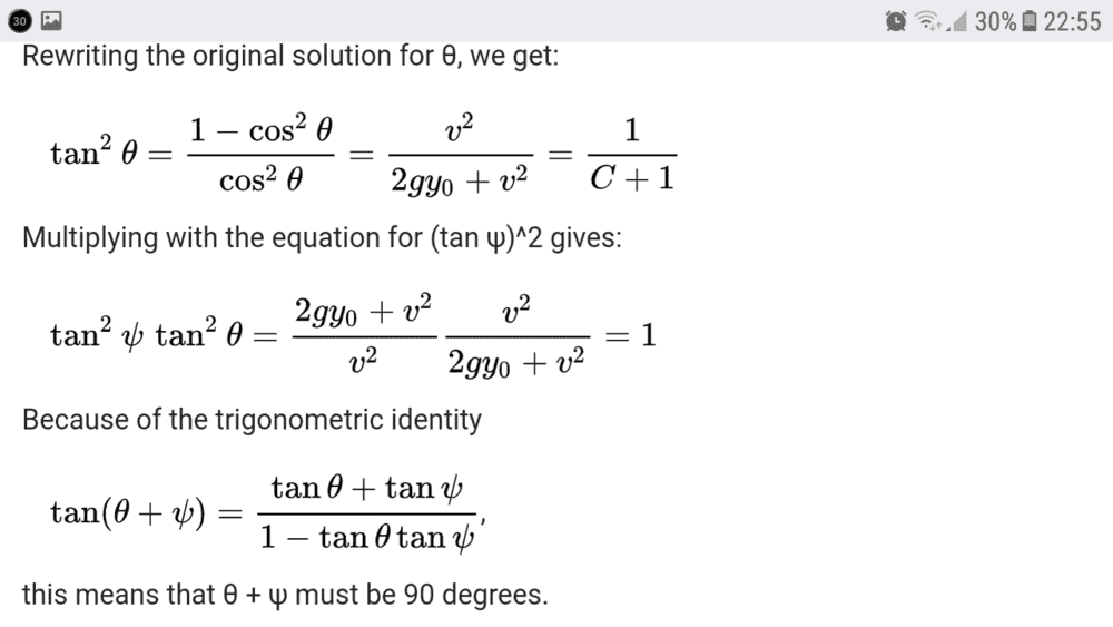

In summary, the ball with a mass of 0.1 kg is kicked with an impulse of magnitude 24.2 N at an angle of 30 degrees with respect to the horizontal floor.
AncientOne99
32
[/B]
Ball with a mass of 0.1 kg travels at a speed of 10 m /s to the boy.
Boy kicks the ball with foot so that it bounces back at an angle of 30 degrees with respect to the horizontal floor. The ball falls back to the ground 20 meters from the boy.
With what average force and under what angle with respect to the horizontal floor did boy kick the ball if the collision took 0.1 second?

You are trying to find the angle that the force was applied. You need to do a vector diagram for force/momentum.
Note that the angle of the force is not necessarily the angle of the trajectory.

I saw some trigonometric identity for this problem but i don't understand it geometrically, any idea?

The ball is initially moving (horizontally at ground level, you will need to assume) at u=10m/s.
The boy's kick is an impulse of magnitude p at an angle to be determined (please say whether you want to call this α or β). The ball then rises at speed v and at an angle of θ=30 degrees to the horizontal and lands s=20m away.
From s and θ you can find v.
My recommendation is always to keep everything symbolic, only plugging in numbers at the end. There are numerous benefits.

So we are searching horizontal angle of the FORCE
AncientOne99 said:
Right, alfa is 30 degrees, i will just check if its right now
This is very confusing. What are you meaning by alpha there? I asked you to decide whether to call the angle of the applied impulse alpha or beta. I used theta for the 30 degree angle the ball flies up at.
Yes.
Ok, solved. Thank you very much for assistance. Mark
