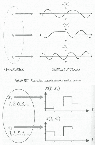

Sure, the book says: "A stochastic process X(t) consists of an experiment with a probability measure P[.] defined on sample space S and a function that assigns a time function x(t,s) to each outcome s in the sample space of the experiment. A stochastic process assigns a sample function to each outcome s."
When it says "A stochastic process assigns a sample function to each outcome s.", I understand that the one-shot experiment (say rolling a die) performed and an outcome came out. Since each outcome assigned to a time function by definition, an "assigned" time function also realized. Since I am doing this experiment at a time t, this time function will have a value at time t.
However from examples given in the book I understand this: A one-shot experiment (say rolling a die and assigning outcomes to random values as {even}=1 or {odd}=-1) is done repeatedly across the time which is first trial and also which creates first time function (or sequence of 1's and -1's). You complete the first experiment. Then again you perform the same one-shot experiment repeatedly across the time and generate second time function, you complete the second experiment, so on. By doing this, you have many time functions each is assigned to order of the experiment such as first experiment, second experiment, so on. At each time function, you have sequences of realizations of SAME random variable.
Therefore, I don't understand how so defined assignment business works between sample space and sample functions?
It gives these figures:

It's interesting that when I look up stochastic process on the web, I find hits that use the same jargon "time function" as your materials. I think it is more precise to say "function of time" than a "time function". (And I prefer the definition of stochastic process that does not insist on involving time. However, let's discuss the one you are using.)
If you wanted to view throwing a single die once as a stochastic process you would need to define a process that mapped the possible outcomes to functions of time. You could define functions of time that only existed at the single point t = 0 and have the event of rolling a 3 mapped to the function X(3,t) have this function only exist at t = 0. That still leaves open the question of what the value of the function X(3,t) would be. There is no law that says X(3,0) = 3 or even that X(3,0) is a real valued function. You have a lot of freedom of choice in how you regard the throw of a single die as a stochastic process.
Suppose you want to look at repeated rolls of a single die and classify the result as even or odd. It is not correct to say that your are looking at repetitions of "the same random variable". What you mean is that your are looking at repeated samlples from independent random variables that have the same distribution. ( If they were literally "the same random variable", they would all have the same outcome. ) Let's consider the outcomes for one roll of the die to be {even, odd}. The sample space for repeated rolls of the die does not have the same outcomes. It isn't the same sample space. An outcome for repeated rolls of die is an infinite sequence. Each element of the sequence is either "even" or "odd".
In general, whenever you consider a sequence independent samples from independent, identically distributed random variables, the probability space for such sequences is not the probability space of just one of the random variables. It is a countably infinite "product" of such probability spaces.
If we look at the probability space for repeated rolls of the die as suggested above, outcomes are infinite sequences such as s = { even, even, odd, even, odd,...}. Infinite sequences have a first term , second term, etc. So if you want to define a stochastic process, one natural way would be to say that X(s,j) is the function whose value at (s,j) is the jth term of the sequence s. If we decree that the argument j represents time, then this defines X(s,t) for t = 1,2,...
I think the main source of your confusion is that your are trying to visualize the sample space involved in a stochastic process X(s,t) as something finite and easy to describe. In most practical examples, the sample space for the process is quite complicated. It's often "all possible trajectories" of some time-varying quantity. At least that makes the mapping from an outcome in the sample space to a function of time rather simple.
You are right, I try to visualize the sample space and stochastic process together, because books define it in that manner, however examples are not representing quite same picture. It is easy to make reasoning when you say it is indexed sequence of infinitely many random variables. However when you say to assign each outcome of sample space to a function of time, it doesn't make sense, I can't find a useful example for it. (I tried to give an example as a single roll of a die, and you positioned it to correct definition of a random process.)
From your explanations I understand,
1. The mathematical object that is assigned to a function of time is simply a trajectory (sequence), an element of "all possible trajectories". A trajectory is considered as an outcome.
2. Each point in a particular trajectory is defined by X(s,j) which is realization of a random variable at index j.
Then this example fits to our discussion: Temperature of a place is measured everyday at 10:00am for annual intervals.
a. The temperature sequence for 2011 is a function of time. All these functions could be named {..., 2010, 2011, 2012, ...}
b. Measuring temperature each day (= one-shot experiment) is a realization of a random variable W with a range of possibly all R. Domain (sample space) of this one-shot experiment for this case is again all R. (W:R→R)
c. If we fix time or index to January 1st, then this represents a random variable X(ω, Jan 1st)=X(temperature of January 1st for all years).
d. If we fix ω=2011, then this represents fixed "outcome", namely X(2011,t) which is function of time as I said at (a). Of course I am not counting 2011 as time. It identifies a particular function of time (trajectory) from others.
I hope I clarified things correctly. Thank you very much for taking your time with this. I appreciate it.
