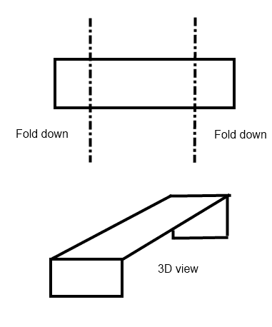

Now that's a blast from the past. More than 35 years ago when I was at school we would take small strips of paper about 3 inches long and 1 inch wide (perhaps a bit less). Fold down the short sides 90 degrees to form vertical surfaces about 1/2 inch tall at each end. They would spin as described. (eg They pitch up and keep pitching up). Sometimes they needed to be given an initial "flip" when launched to set them spinning (eg pull down on the trailing edge as you launch them). They would fly considerable distances if launched from the maths tower building.
