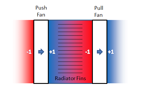

I have a question about fans and airflow, specifically related to processor cooling. I have a large heatpipe/radiator on my processor which came with one fan installed that blows air across the fins (a push fan). The assembly is set up to be able to add a second fan on the opposite side to pull air out of the radiator (push-pull configuration). They sell the cooler pre-installed with both fans for an extra $20 or so. What I’m curious about is if this second fan is actually that useful, or is it mostly marketing hype?
My thought process goes like this:
The initial fan moves 120m3/h of air. If I put one of these on, it will push 120m3/h into and across the cooling fins. If I now put a duplicate fan pulling from the other side, it's going to pull that same 120m3/h that the first fan pushed into the fins. It would have more power (i.e., if the air were suddenly thicker and harder to move) but would not pull a greater amount of air or move it any faster. Am I right in my assumptions or totally off base here?

QuantumPion said:
Your reasoning is incorrect. Fans work by creating a pressure differential. The stated flow rate for a particular fan is based on a single fan in isolation. Putting two fans together will increase the air pressure differential, causing a greater flow rate and thus greater cooling capacity.
If each fan is the same, then they should have the same negative pressure on the back of each fan and positive pressure on the front. I know I'm simplifying, but shouldn't those be about the same value? If that's true, then the positive pressure in front of the push fan would be of equal magnitude to the negative pressure on the back of the pull fan, so it would still be the same speed (see the attached pic). I'm sure that it might increase slightly because the cancellations of pressure would decrease the amount of work each motor has to do, but I wouldn't think it that significant.
This would only be true if the separation between the fans is so large that there is no net air flow from the first fan making it to the inlet of the 2nd fan, which is obviously not the case over the width of a CPU heatsink.
No. The pressure difference would be +1 - (-1) = +2.
The first fan is moving air that starts at zero velocity. The second fan is not. Therefore you will not get the same pressure difference across each unless they have different designs and/or run at different speeds.

People overcomplicate the issue. A fan has two ratings: free air flow and maximum pressure with no flow (delta-P). Between those two extremes lies a curve of flow versus back pressure.
If you put two fans side by side (parallel), you effectively double the flow at all back pressure points but the maximum delta-P doesn't change.
Putting two fans in series doubles the available delta-P but keeps the maximum free air flow the same.
Plotting on an x/y graph with y=pressure and x=flow, parallel stretches the curve out on the x-axis and in series stretches the curve up the y-axis with the basic shape of the curve staying the same in each case.
The last thing to consider is that it requires 4 times the pressure to double the air flow through some restriction.
So - putting a fan on each side of a heat sink will give you about 40% more flow (square root of 2) because you've doubled the available pressure. Of course, other considerations such as heat flow off the processor into the heat sink and propagating through the heat sink also apply so you may not gain 40% more processor cooling.
