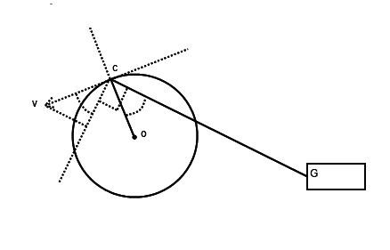

Take a look at the enclosed diagram. It shows a general offset crank not the one in the problem.
GC is the connecting rod
CO is the crank
At any instant the connecting rod is rotating about the Gudgeon pin G.
At the other end the crank is rotating with velocity V tangential to the crank disc.
The velocity at 90 degrees to the connecting rod is Vcos(∠OCG). That's a maximium when ∠OCG = 0 or 180. Which is also TDC or BDC
The velocity at 90 degrees to the connecting rod is Vcos([itex]\angle[/itex]OCG). That's a maximium when [itex]\angle[/itex]OCG = 0 or 180. Which is also TDC or BDC
Thanks, CWatters, that makes sense mathematically, since cos 0,180 = 1,-1.

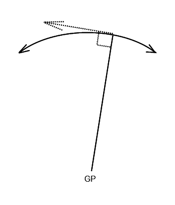

Sorry to go on, but does the maximum velocity of the connecting rod occur at TDC, & BDC, because at that instant there is no horizontal velocity (piston movement)? Therefore, 100% of the tangential velocity of the crankshaft (OC) is utilised to move the connecting rod (CG), obviously disregarding friction, inertia, etc.
does the maximum velocity of the connecting rod occur at TDC, & BDC, because at that instant there is no horizontal velocity (piston movement).
No you can forget what the piston end is doing. It's all about the other end..
Imagine you were sat riding on the gudegeon pin looking towards the crank end. From that viewpoint..
1) the GP end appears statationary
2) the crank end appears to waggle left and right as per the attached drawing.
The angular velocity would be zero when it changes direction and a maximium "somewhere" inbetween. It would be dangerous to assume that the fastest point was exactly in the middle as in some situations it might not be..
To work out the angular velocity you need to know the velocity with which the far end is moving back and forth by writing an equation for the velocity shown dotted. Note that this is not the same as the crank velocity. It varies with the position of the crank. See previous drawing for the trig used.
Then when you have the equation you work out when the equation is at a maximium.
It so happens that this is when the piston is at TDC or BDC but for other types of machine it might not be.
Thanks for your reply, again.
Ok, so the velocity, v, at point C would be:
vC=rOCOC.cos(180-[itex]\angleOCG[/itex]), so would be at a maximum when [itex]\angleOCG[/itex])=0° or 180°.
