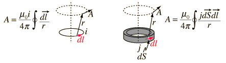

The vector potential is defined to be consistent with Ampere's Law and can be expressed in terms of either current i or current density j (the sources of magnetic field). In various texts this definition takes the forms
I got this from http://hyperphysics.phy-astr.gsu.edu/hbase/hframe.html
Regards
Thanks, but I don't think that's correct in this instance. In my book current and current density are usually denoted at J0 or I0. I'm fairly certain that in this instance j is the same as the imaginary unit, i, indicating that it's coefficient is the imaginary part of a complex number. Also these field equations were originally derived from;
