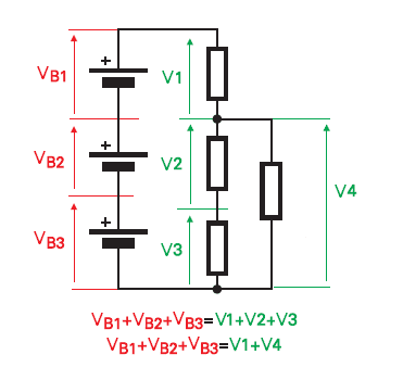

And another example
Vs - V1 - V2 = 0 ⇔ Vs = V1 + V2 ⇔ 0 = -Vs + V1 + V2
Simple algebra :)
