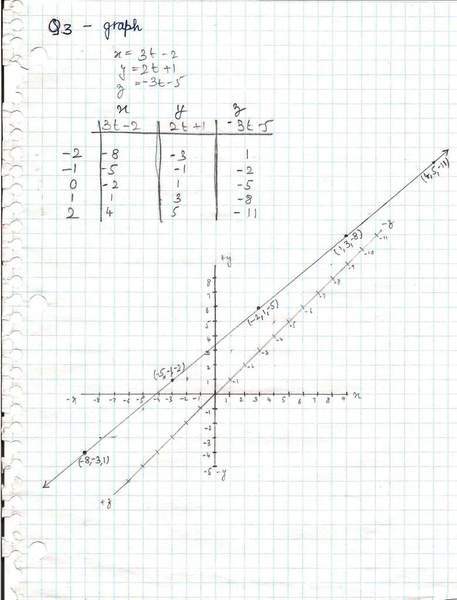

Write the parametric and vector equations of:
x + 2 / 3 = y − 1 / 2 = z + 5/ -3
x=-1+5t
and plot a graph of this line when t = −2, −1, 0, 1 and 2.
vector:
r= [-2,1,-5]+t[3,2,-3]
parametric
x=3t-2
y=2t+1
z=-3t-5
using parametric equation:: i drew the graph, please check if the graph is correct at -2,-1,0,1,,2

Not sure where that x = -1+5t came from. But your parametric equations look correct. I didn't check all your points, but if you plotted the points to scale as apparently you did, and they came out on a straight line, aren't you pretty confident in the answers?
actually i was worried about the axis ... in specific the z axis.. i just had this gut feeling like i took -z the wrong direction ...

Based on your subsequent work, your symmetric equations need parentheses.
Here are the equations, using LaTeX.
$$ \frac{x + 2}{3} = \frac{y - 1}{2} = \frac{z + 5}{-3}$$
When you write them in plain text, they should look like this:
(x + 2)/3 = (y - 1)/2 = (z + 5)/(-3)
What you wrote means the following:
x + ##\frac{2}{3}## = y - ##\frac{1}{2}## = z + ##\frac{5}{-3}##
f22archrer said:
x=-1+5t is part of the question .
Then doesn't it seem odd that you are saying x=3t-2 in the solution? I assume when you are writing "x + 2 / 3" you mean (x+2)/3, not x+(2/3). But even assuming that, your parametric form looks screwed up. Put x=(-1)+5t into (x+2)/3=(y-1)/2 and solve for y in terms of t. The 't' in your equations is the wrong parameter. Your are going to get the same line, but the points corresponding to a given value of t will be different.

Are you asking how to solve
[itex]\displaystyle \frac{(-1+5t)+2}{3}=\frac{y-1}{2}[/itex]​
for y ?
Give it a try.
What do you get?

y =[5+10t]/3

Then you have two different expessions for x a function of t. What are you supposed to use?
next i need to find vector and parametric equation and then plot for t ...|
This seems like a very strange way to phrase the problem, making me wonder what the exact statement of the problem is.

Taking the problem as you have quoted, don't use ##t## here. You apparently should write:
x=3s-2
y=2s+1
z=-3s-5
using s for your parameter. Now if x = -1+5t you can put that in and get s in terms of t. Then use that in these last three equations. Of course, this all assumes I understand what you are trying to do.
