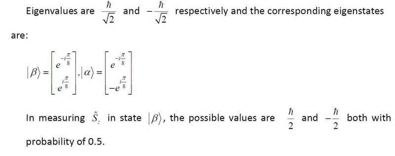

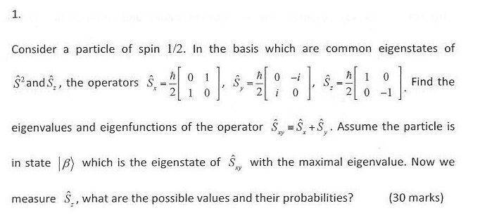

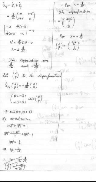

I don't know what's wrong with my work. I can't obtain the eigenvector provided in the model answer.
My work
Model Answer

Your work is fine. Remember that an eigenvector is only unique up to a multiplicative constant. The eigenvector you found can be written
$$\left\lvert \frac{\hbar}{\sqrt{2}} \right\rangle = \begin{bmatrix} \frac{1-i}{2} \\ \frac{1}{\sqrt{2}} \end{bmatrix} = \frac{1}{\sqrt{2}}\begin{bmatrix}\frac{1-i}{\sqrt{2}} \\ 1 \end{bmatrix} = \frac{1}{\sqrt{2}} \begin{bmatrix}e^{-i\pi/4} \\ 1 \end{bmatrix}.$$ If you multiply that by ##e^{i\pi/8}## and ignore the normalization factor of ##1/\sqrt{2}##, you'll get the answer in the solution.
Oh! Thank you very much.
But why do we bother to have such a complicated eigenvector?
The one with (1-i)/2 and 1/(sqrt2) is much easier to find. Why do we need to change it to the form of exp?
You don't need to, but you have to admit there's certain symmetry there. And physicists like symmetry. :wink:
