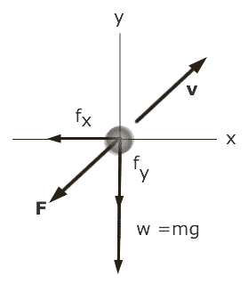

Have a look at the image
I can see there that if the angle were greater than 45, than the y component of the air resistance would be greater meaning more force pushing it down. Therefore, I can get why there is a big difference between actual and ideal at angles greater than 45(sort of).
But what about when the projectile is coming back down? The air resistance would be pushing it back (like the y component of the Fair is pushing it back into the air), would that negate the effects described in the above paragraph or not?

OK thank you. I do appreciate your previous help.Can anyone tell me if I am correct in making the assumption about the air resistance as per the image above, when the angle is greater than 45°, the y component of the air resistance would be greater than its x, therefore acting downwards it now has gravity and most of the air resistance, causing it to decelerate towards the ground faster than if it was shot at angles below 45°?
I can see it both ways, as if the angle was below 45° the x component of the air resistance is greater than its y, but then it has gravity acting down, and the air resistance simply pushing against it, which would still slow it down. But I am not sure if it would slow it down just the same as above or not as fast?

For an intuitive grasp consider the extreme case: minimal gravity and extremely high drag. No matter at which angle you shoot, the drag will slow the projectile after about same direct distance to almost zero, from where it will sink slowly and almost vertically. So it is obvious that you have to fire almost horizontally to maximize the horizontal distance.
All the other optimal cases are somwhere between the two extremes:
45° for drag = 0
~0° for drag -> [itex]\infty[/itex]
