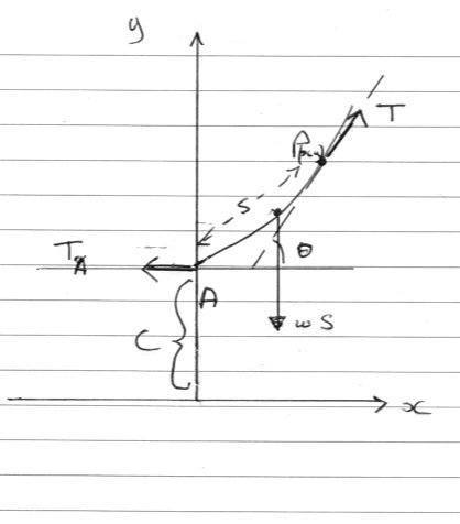

Aleph Zero was correct in that for a complete catenary, suspended between two points we do not measure from the lowest point we measure from the directrix of the catenary which is at a distance c below this. So the tangent at the lowest point where dy/dx=0 is parallel to the x-axis and c above it. Let us say this passes through the point A so that A is c above the origin as in my diagram. I will return to how we derive c later and include the condition for c to be zero.
Let us consider the equilibrium of the lowest point A and let this have a tension T0, whatever that works out to be.
Because the slope of the chain or rope is zero at A TA is purely horizontal.
If w the weight of rope or chain per unit length then Let TA = wc for some distance c.
This is where we introduce c, but do not yet know that it is the distance shown on my diagram. That remains to be proved.
Now consider equilibrium of a length of rope or chain running from A to any point P(x,y) as shown.
This length is in equilibrium under the influence of three forces. TA; The (different) tension T at P and the weight of the rope = w times the arc length s = ws
I said that there are 5 main equations relating to the catenary, this leads to the first.
[tex]\begin{array}{l}
T\cos \theta = wc...{\rm{ = }}\left( {{{\rm{T}}_{\rm{A}}}} \right)...{\rm{H}} \\
T\sin \theta = ws......{\rm{V}} \\
\tan \theta = \frac{s}{c}\quad s = c\tan \theta ......{\rm{1}} \\
\end{array}[/tex]
Since [itex]\tan \theta = \frac{{dy}}{{dx}}[/itex] and
[tex]\frac{{ds}}{{dx}} = \sqrt {\left( {1 + {{\left( {\frac{{dy}}{{dx}}} \right)}^2}} \right)} = \sqrt {\left( {1 + \frac{{{s^2}}}{{{c^2}}}} \right)} [/tex]
Then
[tex]\frac{{ds}}{{\sqrt {\left( {{c^2} + {s^2}} \right)} }} = \frac{{dx}}{c}[/tex]
Integrate
[tex]{\sinh ^{ - 1}}\left( {\frac{s}{c}} \right) = \frac{x}{c} + D[/tex]
Since s=0 when x=0, D=0
[tex]s = c\sinh \left( {\frac{x}{c}} \right).......2[/tex]
Also in 1 we have
[tex]\frac{{dy}}{{dx}} = \frac{s}{c} = \sinh \left( {\frac{x}{c}} \right)[/tex]
Integrate
[tex]y = c\cosh \left( {\frac{x}{c}} \right) + E[/tex]
Choose that when x=0, y=c, giving E=0
[tex]y = c\cosh \left( {\frac{x}{c}} \right).......3[/tex]
From 3 we have
[tex]{y^2} = {c^2}{\cosh ^2}\left( {\frac{x}{c}} \right) = {c^2}\left( {1 + {{\sinh }^2}\left( {\frac{x}{c}} \right)} \right) = {c^2}\left( {1 + \frac{{{s^2}}}{{{c^2}}}} \right)[/tex]
Which yields equation 4
[tex]{y^2} = {c^2} + {s^2}.........4[/tex]
Finally if we square and add equations H and V from the beginning and substitute we obtain the fifth equation which I posted before.
{T^2}\left( {{{\cos }^2}\theta + {{\sin }^2}\theta } \right) = {w^2}\left( {{c^2} + {s^2}} \right) = {w^2}{y^2} \\
T = wy.........5 \\
\end{array}[/tex]
This shows that the tension at any point P(x,y) is the same as the weight of a rope or chain hanging from that point to the directrix, where we have placed the x axis.
Finally for a rope or chain that is hanging straight down from a single support the origin and A coincide, as does the 'tangent' through A and the x-axis because since there is no horizontal force TA=0 in which case c = 0 since TAwc and w≠0. Thus y is measured from the lowest point of the chain or rope.
