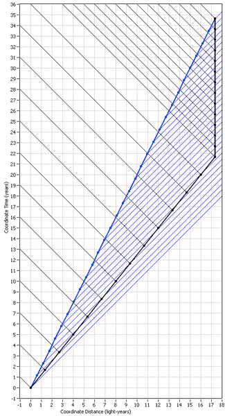

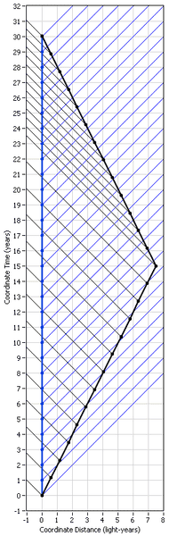

No, your brother will not receive many messages from you at the moment of his about-face. His about-face will not cause him to receive any messages from you. What's going to happen is that for the first half of his trip, he will receive messages from you at a slower rate than he sends them (1/R as I said in my first post to you), then for the second half of his trip he will receive messages from you at a faster rate than he sends them (R).
So for your example of your brother traveling at 0.5c, we can use the Relativistic Doppler formula to calculate what R is:
√((1+β)/(1-β)) = √((1+0.5)/(1-0.5)) = √((1.5)/(0.5)) = √3 = 1.732
And 1/R is the reciprocal, 0.57735.
This means that he will see your yearly messages coming to him slower than his during the first half of the trip. In fact it will take 1.732 years before he sees your first message.
And for the last half his trip, he will see your messages arriving more often than once per year according to his clock. It will only take 0.57735 years between each of your messages.
Now without knowing how long the trip will take, we can average these two numbers:
(1.732+0.57735)/2 = 2.30935/2 = 1.154675
This is the final ratio of your two clocks when he returns. How ever many years it took him according to his clock, yours will be 1.154675 times that amount.
So let's say your brother travels away at 0.5c for 13 years and then takes 13 years to get back at the same speed. Here is a spacetime diagram to show what is happening according to your rest frame. I show you as a thick blue stationary line with dots every year and your messages going out as thin blue lines traveling at c. I show your brother as a thick black line traveling at 0.5c with black dots every year and his messages coming back to you as thin black lines:
Now let's see how the previous calculations based on Relativistic Doppler fit in with this diagram. First off, I said that the rate at which your brother receives your yearly messages take 1.732 of his years. Can you see that on the graph? For example, at about his year 12, just before he turns around, he is just receiving the message you sent at your year 7. Can you follow that? If we divide 12 by 7 we get 1.714 which is about right. (We don't expect it to be exact because he didn't receive your message exactly at his year 12.)
