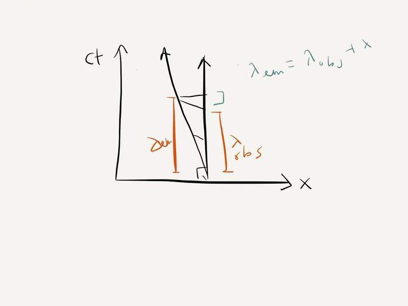

1. Use geometry to derive z=v/c where c is the speed of light and z = [v(obs)-v(em)]/v(em).

First of all, you have to be careful with your symbols. Physicists often use the Greek letter "nu" (##\nu##) for frequency, rather than f. This is not the same thing as ##v##, the velocity of the source of emission. Secondly, your equation for redshift, in terms of frequency, should be ##z = (\nu_{em} - \nu_{obs})/\nu_{obs}##, as opposed to what you have there.
As far as solving the problem, using "geometry" just involves thinking about the source of emission receding from the observer, and considering the observed vs. emitted frequency that results. To do this, consider two successive wavefronts of the EM wave. After all, the frequency is just how often wavefronts pass by. Have the first wavefront be emitted at t = 0, when the source is a distance d from the observer. Then the second wavefront is emitted at a time t = Δtem later, this being the period between wavefronts, (which is the reciprocal of the emitted frequency). Note that at this later time, the source is now farther from the observer, so the second wavefront has a longer distance to travel than the first one did. At what time t1 does the first wavefront arrive at the obsever? At what time t2 does the second one arrive? What is the difference Δtobs between them? How does this differ from Δtem? So what is the frequency shift?

Anyway, here's a picture I drew (sorry, I'm on a tablet so it's kind of messy)
So I'm guessing here that I can see that λ(obs)= λ(em) + x, and use that to figure out that z=x/cΔt = [itex]\nu[/itex] /c.
Is there significance in the fact that the it's an isosceles triangle?

I don't think you need a spacetime diagram.
Did you try the method I suggested using wavefront arrival times?
What is 'x' in your previous post ?

You're thinking along the right lines, you're just not quite getting the details. Say t = 0 is when wavefront 1 is emitted. Also, t2 is when wavefront 2 arrives. t1 is when wavefront 1 arrives. I'm assuming that Δt_x is the travel time required for wavefront 2. Therefore t2 is not t1 + Δt_x, because that would mean that wavefront 2 wasn't emitted until after wavefront 1 arrived. Instead, t2 = Δt_em + Δt_x, since Δt_em is the time interval between the emission of the two wavefronts.
