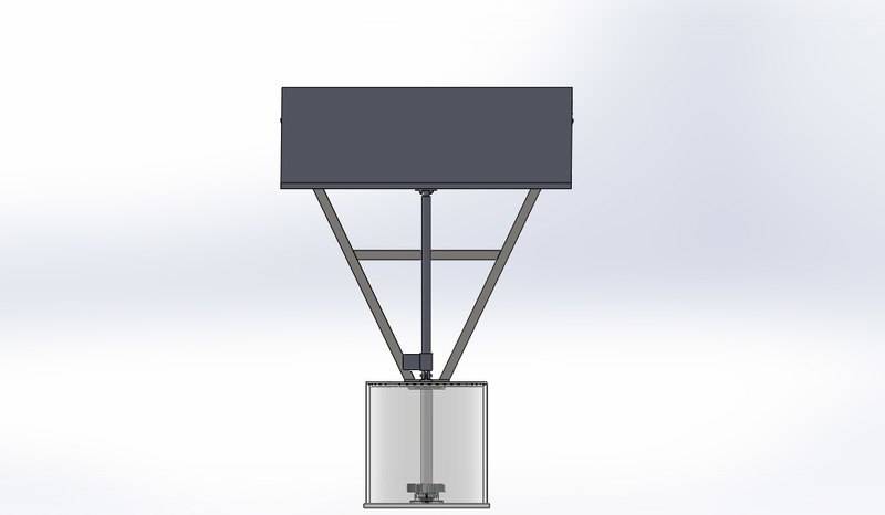

hi
i am currently designing a solar tracking system. i am confused at the point of calculating the torque required to rotate the solar tracker. i have a shaft in the cylinder which is rotating with 4RPM.
i know that Power= Toque* angular velocity or 2*pi*RPM* Torque
where Torque is= Force* radius
radius= should i take the radius of the shaft? ( please see the picture)
Force= how can i calculate the force?
i know its stupid but i am confused and i need to continue with this
thank you
For gravity, radius is the horizontal displacement of the center of gravity of the system relative to your axis. And force is just the weight of the structure.

Ummmm...no. Wrong approach.
You want torque required to turn the assembly. More specifically, you want the torque required to accelerate that assembly to a desired rotational speed in a desired time. That is
T = Jα
Torque = (Mass Moment of Inertia of the Assembly about the shaft) X ( angular acceleration)
...and angular acceleration is approximated by ΔAngularVelocity / ΔTime .
But this is not sufficient. You must size the driver/motor/gearing for maximum peak torque. That includes rotational inertial torque plus every other resistance to rotation that you can dream up (friction, stiction, wind, gravity, cobwebs, yadda yadda yadda). You need to analyze it for slowing down to a stop & holding it steady also. Then awww, what the heck, double that and use that to size your driver/motor/gearing.
If this assembly is designed with a CAD system of any useful power, then you can use the CAD system to calculate the MMI about the shaft. It can be done manually, but it would sure be tedious.
The only instance of using "radius" for this type of analysis was if you have a Radius of Gyration of the assembly...but that's too darn much trouble to fool with.

i got the above results from solid works. i am lost.. moment of inertia should i use?

Perhaps not. It's a simple calculation to be sure, and a disastrous project if it is not negligible. If one must accelerate a massive object to even a slow speed, significant torque must be applied to get it moving from zero speed. Once the mass is in motion, then the torque requirement will be reduced. Only if the motor must overcome gravity effects of the "weight" and therefore must counteract an induced torque T=WgL. Otherwise it's **inertia**. The wide dimension of this panel structure will produce a significant inertia due to the distributed masses away from the axis of rotation.
Regarding whether your SolidWorks-calculated inertia is Ix, Iy, Izz, or anything else: You must get the Mass Moment of Inertia of the mass **about the desired rotational axis**.
This is probably NOT the CAD model coordinate system axes that are given by the values you listed. So you must read the SW help file and (what? don't remember exactly) either have it calculate about a new reference geometry Axis or new reference geometry Coordinate System that you assign at the correct location to give you the answers you need.

The system just has to complete one cycle per day. Let's assume it accelerates from rest to ##\omega=\frac{\pi}{24hours}## in 1 second (quite quick!). For a point-mass m with distance d to the axis, this requires a torque of ##md^2\frac{\pi}{86400s^2}##. Required static torque due to its angle relative to the vertical position is ##md\sin(\alpha)g##.
Assuming d<100m (we don't want to rotate a skyscraper, right?), static torque is larger for ##\alpha>0.00037##. For d=100m, this is a deflection of just 4cm at the top. I am sure the system is designed to operate with angles some orders of magnitude larger. It is easy to extend this analysis to arbitrary shapes, the conclusion stays valid as long as the structure does not exceed 100m (or 1000m, if you remove one 0 from the angle...).

Acceleration torque is moment of inertia about rotational axis times the angular acceleration.
but Should we factor ------- Weight of payload X Distance between motor axis and CG of payload as well ??
And add both of them?

It also has to overcome wind force on the structures (panels I presume). Worst case wind force is likely an order of magnitude higher than those other forces.
You need a design wind speed. You also need to rapidly move the panels to the feather position if winds exceed design speed. Alternatively, you would need a clutch to decouple the drive system and design the aerodynamics of the structure to self feather like a wind vane does.

You must use the parallel axis theorem to find the proper moment of inertia (including payload) when the center of mass does not coincide with the axis of rotation:

Yes. This has been answered over a month ago in the previous posts.
