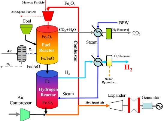

Fan discovered a way to heat coal, using iron-oxide pellets for an oxygen source and containing the reaction in a small, heated chamber from which pollutants cannot escape. The only waste product is therefore water and coal ash -- no greenhouse gases.

The chemical looping process out of OSU does create carbon dioxide, though there's no hot exhaust products 'smoke stack' required. The article has it wrong, or is at least sloppy. An advantage claimed here is the process creates nearly pure CO2 in an already separated stream ready for storage; it doesn't have to be separated from a exhaust flume containing combustion products.
C11H10O (coal) + 26/3 Fe2O3 → 11 CO2 + 5 H2O + 52/3 Fe

... An advantage claimed here is the process creates nearly pure CO2 in an already separated stream ready for storage; it doesn't have to be separated from a exhaust flume containing combustion products.
Thanks for the explanation mheslep. I looked at it and saw the CO2 was being produced but didn't understand what was unique about this set up.
What combustion products? The primary combustion products of coal are CO2 and water anyway and condensing out the water is both easy and boosts your efficiency, leaving you with just CO2 and only trace amounts of other stuff -- not much different from the claimed benefit of this process.

That was my first thought - elimination of CO, H2S, SOx, etc. Yes they get that benefit but that's not the major motivation. According to them one of the cost drivers of CO2 sequestration is low concentration of CO2 (relative to N2).
Liangshih Fan said:
Moreover, coal combustion with air produces a flue gas stream at atmospheric pressure that consists of ∼80% N2 (by volume) and 10–15% CO2. The low concentration of carbon dioxide in the flue gas stream makes carbon capture from traditional coal combustion power plants inefficient and uneconomical.
Other efforts such as chilled ammonia process and oxyfuel combustion process focus on the cost reduction for CO2 capture in coal combustion plants. These carbon capture techniques, however, would consume 25–28% of the total electricity generated from the power plant (Châtel-Pélage et al., 2005).
For example, the state-of-the-art CO2 capture technique would increase the cost of electricity by 25% in a coal based IGCC plant (NETL, 2007). Thus, future coal gasification processes should be simplified through process intensification and coupled with more efficient carbon capture schemes in order to reduce the capital investment and to further increase the energy conversion efficiency. The implementation of the chemical looping concept in coal gasification processes represents a promising method to achieve these goals.
Another advantage is they claim an all-in energy efficiency of 64%, versus ~45% with the latest super critical coal boilers.

My take away from the article is that, economically, CO2 sequestration is really two part problem: 1) cheap separation, 2) burial (or reuse?). They are apparently claiming an innovative solution for part one, which was not trivial. Part two, burial: left as an exercise to the reader.
