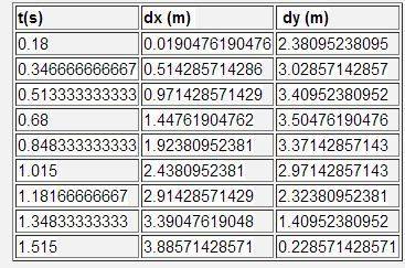

A basketball was shot in the air. Use the following data to produce a horizontal position-time graph and a vertical position-time graph
1. Determine the initial velocity of the basketball.
2.What was the maximum height of the basketball.
3. What is the velocity of the basketball at its lowest point?
4.Determine the average acceleration. How did you determine this value?
aave=Δv/Δt
v2=v20+2aΔx
v=v0+at
I used the initial values of dx and dy as the components of the initial velocity. I found that the initial velocity is 13.2279365m/s at an angle o 89.54*. For the maximum height i was planing to use the initial velocity and acceleration to find the height and then use another equation to find time. However i don't know what the acceleration is and i cannot assume is 9.8m/s^2. Help! Thank you!

Plot the data and sketch the curves in.
You can work out the acceleration (in the y direction) by plotting the actual dy data and what would have happened had there been no acceleration. Then you'll see how much speed is lost in each time interval. ##a_{ave}=\Delta v/\Delta t##
Why not use the data to determine the maximum height?
Aside: be sure to point out that you are estimating the initial velocity from the average velocity in the first 0.18s ... I don't know how accurate you are supposed to be.

That does not mean you cannot use the data to determine it - it just means the max height is between two measurements. That's why you plot the data and fit a curve ... the curve max will be between two data points ... if the data is good, your eyes/brain are actually quite good at interpolation (or you can do the math - computers are good at this). At the very least it will tell you if the calculated values are plausible.

Thank you to both of you. This was immensely helpful and i appreciate the time. I was told not to make assumptions and yet I had to for air resistance.

I would have to do tangent lines to measure the acceleration in the y-dimension and use that average acceleration to "accurately" find the maxim height?
And what would be a more accurate way of finding the initial velocity?
You don't have to - if you plot the data.
With no air resistance - what shape is the graph of dy vs t or dy vs dx?
What shape is the data?
Estimations from averages are probably fine for this project - it's just good practice to make your reasoning explicit: write down what you do and why. You get more marks that way.
Note: I would get initial velocity by figuring out what shape the trajectory is and use a regression analysis to fit the general curve to the data. Not so much because it's more accurate but because the method will also tell me how accurate it is. I'm guessing you are not expected to use regression ...
The shape of dy-time is -x^2, the shape of dx-time is a line. And you are correct we are not expected to use regression.
Well - those would be the shapes if the air resistance were negligible.
Compare with your data. Then you can say whether the data is consistent with zero air resistance and you haven't had to make any assumptions.
That's the approach each step of the way.
If you plot the graph, then you can sketch the curve in.
You must be getting tired of me saying that. These are long answers right? A graph is worth a lot of marks.
If we have a time series for y, then the average speed in the ith time interval is ##v_i=\Delta y_i/\Delta t_i## and you can do the same with the average acceleration in each time interval - you'll have to decide how many sig fig to keep in the data too.
