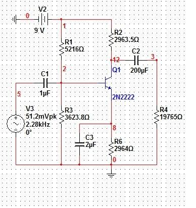

I designed the BJT amplifier below. After substituting in for the values of the actual resistances measured in lab, I reran the simulation. The hand calculation I derived for the gain was nearly spot on with what I was seeing in Multisim.
Now, when in lab I get approximately the same value I should. The only issue is that I seem to have some sort of increasing DC bias on the output. The output will first start out at around 2.11V and slowly creep up until around 3V.
What can I do to avoid this problem? I thought perhaps by adding a larger capacitance, but it did not change much.
Sounds like C2 is installed backward.
At 200 uf it has to be electrolytic...
Its + side should go to the node of Q1 & R2 (your point 12), its - side to R4 (your point 3).
if C2 was backward and passed DC for a good bit, it's likely fried. then get a new C2 and put it in correctly.
The size of the resistors in the circuit will limit the leakage current to less than a milliamp, so it's unlikely you destroyed it.
But after you connect it the right way round, it might take a little while before the capacitance and leakage current settle down to stable values (the chemistry going on inside the capacitor needs to get back to normal). If your measurements still seem to be drifting, just leave it running for an hour and then see what it's doing.
C2 and R4 have a time constant of around 4 seconds. You will have to wait for several seconds for DC voltages to settle (and change)
I am always unsure when it comes to wiring up electrolytic capacitors. How can you be certain which way to orient them?

Observe on your schematic that, in absence of signal, point 12 will be positive about five or six volts (Vsupply minus Icollector R2)
and since the capacitor should block DC, point 3 will be zero.
So the cap should go + side to 12.
When installed backward , electrolytic capacitors don't block DC at all well. They'll 'leak' in the milliamps range. They eventually lose capacitance and some chemistrys like solid tantalum will even catch fire. (I was worried there might be one in my pacemaker that got recalled...)
When installed forward they do a good but not perfect job - DC leakage might be as much as a microamp ..
