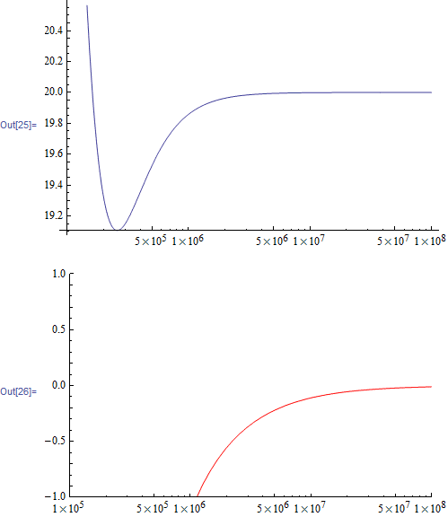

Don't leave the resistors out of the calculation; they will contribute to both the real and imaginary parts of the impedance (thanks to the multiplications and divisions involved in the calculation when things are paralleled).
Looks like there might be a heavy bit of algebra involved...
(By the way, I don't think you're going to find a real-valued frequency ω for which the imaginary component of the impedance goes to zero. That's my assessment based upon experience, looking at the component values ... but don't take my word for it :smile: )
I think you should try to present the problem here exactly like it was presented to you, like you did in your original post.
You'll only be able to show that the imaginary part of the equivalent impedance tends to zero as ω→∞.

I wonder if you have the right schematic for this problem.
You say "my main problem i am having is that i am unable to add the parallel components without knowing w. "
What you should do is leave w as a variable and solve for the value of w which would make the imaginary part of Zeq zero.
However, for the schematic and component values you show in post #1, there is no solution at a finite value of w.
Plotting the magnitude of Zeq and its imaginary part can help you to see the problem. Here are such plots:
The magnitude of Zeq is in blue and the imaginary part is in red.
Your problem says "Calculate the frequency that maximizes the current entering the circuit. To do this, find the angular frequency that causes the imaginary part of the impedance to equal zero." This suggests that the frequency of maximum current is also the frequency where the imaginary part is zero, but you can see in the plots that the frequency at which the magnitude of the impedance is a minimum (that's where the current would be maximum) is not the frequency where the imaginary part is zero. In fact, the imaginary part isn't zero until the frequency is ∞, so to speak.
This is why I think you may have the wrong circuit schematic.

Yes, the algebra for this problem will be a bear. But you do need to leave ω as a variable, since that's the variable you're looking for.
As milesyoung intimated above, and as I also suggested (but did not prove), the imaginary part of the impedance for this circuit won't go to zero for any finite value of ω. This is not to say, however, that you can't find a value of ω that would maximize the magnitude of the current, or the real portion of it. That will take even more algebra and a bit of calculus.
It is possible that the component values of this particular circuit were not well chosen to provide a simple, clear solution where the reactive part of the impedance goes to zero at a real, finite frequency.
