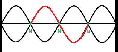

[*]to measure the wavelength of a wave, you must have the length between either: A) two antinodes (peaks,trofts,crests,etc.) or B) THREE nodes. Since we only know the length between two nodes, it is assumed that we can multiply the distance (21.9 cm) by 1.5 to figure out the distance between three nodes.
How is the wavelength related to the distance between two consecutive nodes?

TSny said:
Hello and welcome to PF!
My physics teacher taught us that you can measure wavelength by finding the lambda values. So we count 1λ, 1.5λ, 2λ. etc. etc. Then we use the equation (#λ)(λ)=length of wave segment. Three nodes would be one lambda value and two antinodes would be one lambda segment.

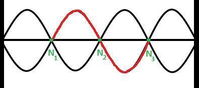

What is the distance in cm between nodes N1 and N2? Between N1 and N3? What is the wavelength in cm?

In physics, to be safe, use meters not cm. There are many constants in physics that assume you are using mks units, i.e. meters, kilograms, and seconds. Recall in chemistry you might use cgs units, centimeters, grams, and seconds.

Ah yes, this is probably the one thing I always over looked, units!
Thank you, I'm going to try it again later!
Yah, I just realized that my main issue was mixing up centimeters with meters. I found the velocity as cm/s but overlooked it and entered it as m/s.
