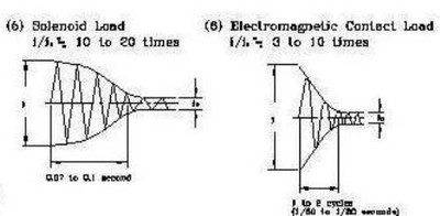

If my anecdotes bother you just skip the post.Two cases here, the AC solenoid and the DC one.
AC solenoid current might look like this:
where the larger cycles are while the plunger is closing the air gap.
The Westinghouose AC relays in my plant were very fast and pulled in in ~ one cycle so you saw only one large peak, somewhat faster than the right hand trace.
We called it "inrush" though "Latching" or "Pull-in" might have been a better adjective.
Pull in current was an amp, holding about 1/10 amp.
Because of its air gap, an AC solenoid core can't saturate on energization like a transformer does.
When airgap closes both inductance and XL increase so current goes down to holding value.
Curent will be V/(R+jXL) and XL is initially small because of the air gap.
If a piece of debris gets into the airgap and prevents full travel the relay cannot close the airgap to reduce its current and its coil burns up. That used to happen with our early relays. They had a ventilation hole right above the plunger , and when the construction electricians skinned wires it was not unusual for a small piece of plastic insulation to fall into that hole and block armature travel. Maunfacturer quickly redesigned to close the top vent hole.Wish I could find a trace for DC solenoid current.
A DC solenoid's current will rise toward V/R on its L/R time constant.
Note there's a glitch when airgap closes and L becomes larger, but it keeps on increasing at the longer time constant.
Small DC relays can be designed with pull-in current that won't overheat the coil so are just a simple solenoid.
Bigger solenoids employ something external to reduce current once the plunger has completed its travel.
