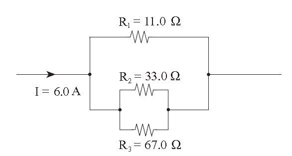

1. The diagram attached shows part of an electric circuit. What is the current through resistor R1?
To summarize:
I=6.0 A
R1 = 11.0 Ω
R2 = 33.0 Ω
R3 = 67.0 Ω
R2 and R3 are in parallel, and R1 and R2 and 3 are in parallel.
I know we aren't supposed to attach pictures of questions, but a diagram does make my question a lot easier to understand.
V=IR
IT in series = I1=I2=I3
IT in parallel = I1+I2+I3
RT in series = R1+R2+R3
RT in parallel = [(1/R1)+(1/R2)+(1/R3)]-1
Using the resistor laws, I can find resistance of R2 and 3 by (1/33+1/67)-1.
Using Kirchoff's Laws, I know that the resistance coming out has to equal the 6.0 A.
But I don't get how all this information is relevant. The question doesn't give me voltage or any other information and I don't know how to figure out how much current goes through each resistor.

Notice that ALL of the resistors are in parallel. Find the voltage across all of them, then find the current through each one.
What's the net resistance of the circuit?
