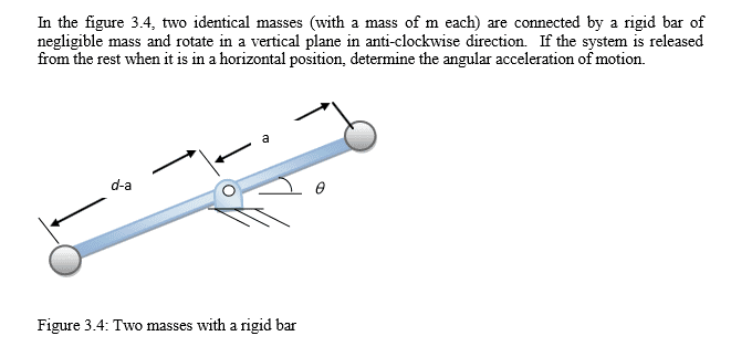

Two identical masses with a mass of m each are connected by a rigid bar of negligible mass and rotate in a vertical plane in an anti-clockwise direction.
If the system is released from rest when it is in a horizontal position, determine the angular acceleration of motion.
So far, this is my progression towards a final solution. Firstly, find the moment of inertia of the system:
I=Ʃ(r^2)(m)
= (d-a)^2(m) + (a)^2(m)
= (d-a)(d-a)(m) + (a)^2(m)
= md^2 - 2adm + 2ma^2
I'm getting stuck after I do this, because I have no idea what to do after I find the moment of inertia in order to find the angular acceleration. I have attached an image to help the visualisation of the situation. Your help would be greatly appreciated! :)
Think about what causes the system to have an angular acceleration. Which way will it tend to rotate when you let it go? Why? What is the rotational analog of Newton's second law of motion?
